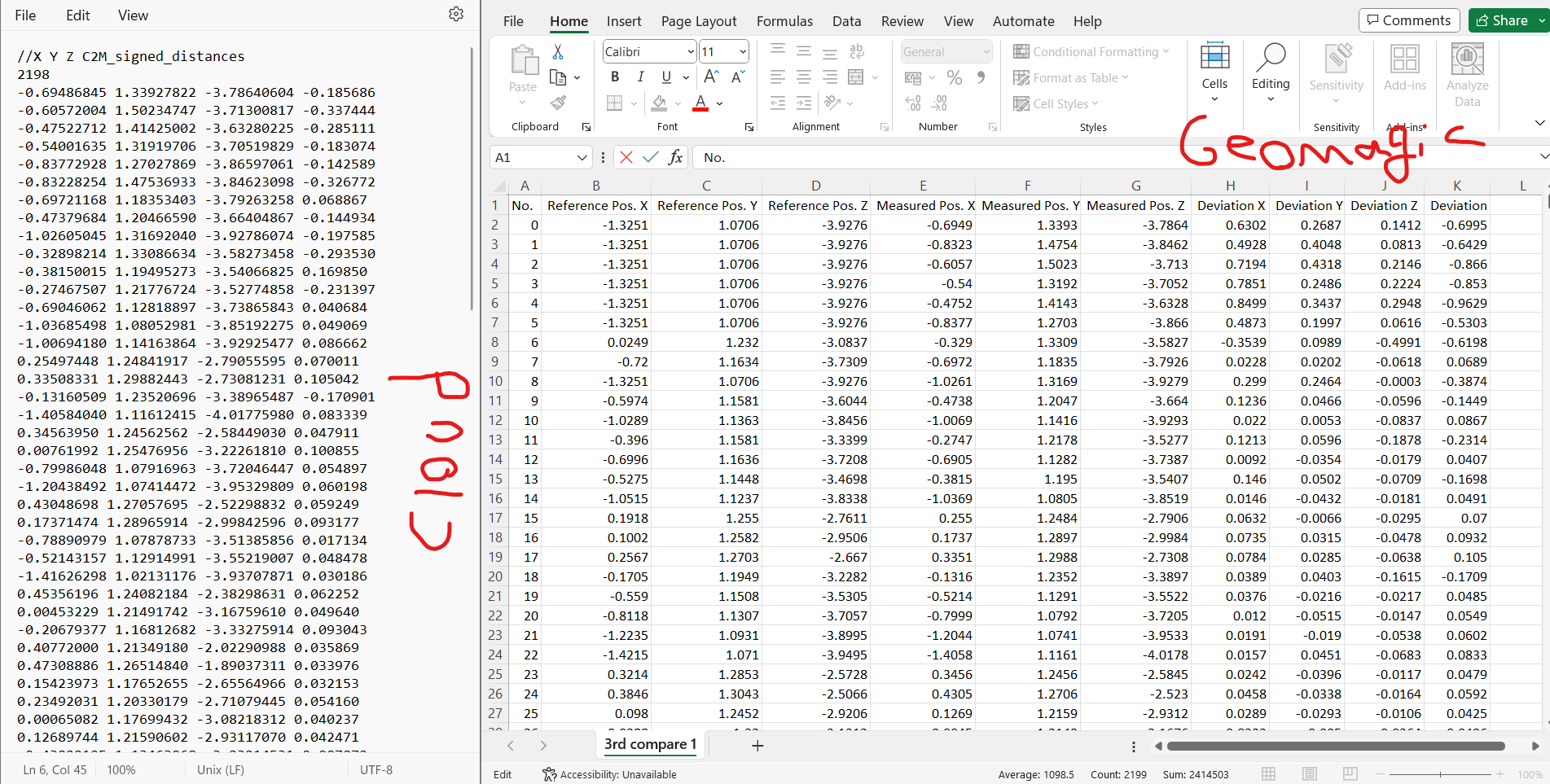

To delve into the intricacies of these software tools, I conducted a mesh superimposition using CloudCompare—employing point pairs alignment followed by fine registration. Subsequently, I computed the cloud/mesh distance, resulting in the following values: Min = -0.686 mm, Max = 0.765 mm, Mean = 0.023357 mm, and RMS = 0.135114 mm.
To maintain consistency, I exported the aligned meshes and imported them into Geomagic Control X without initiating any additional alignment steps. I performed a comparative analysis on the entire meshes (using 3d compare tool), yielding values of Min = -0.6661 mm, Max = 0.6574 mm, Mean = 0.0175 mm, and RMS = 0.1276 mm—values that exhibit noticeable discrepancies from those obtained with CloudCompare.

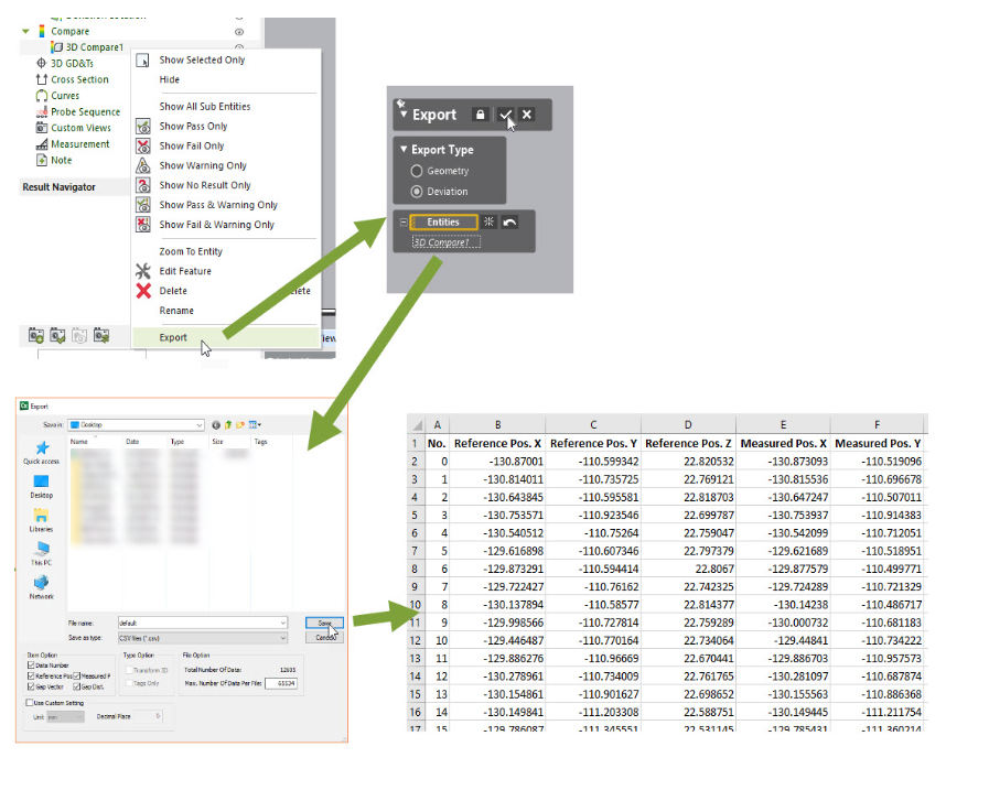

Are you able to export per-point distances with Geomagic?
Re: Inquiry Regarding Discrepancies in Mesh Comparison Results Between CloudCompare and Geomagic Control X
yes
(refer the attachments)
You can review the calculation methods used in Geomagic by following this link.
https://support.3dsystems.com/s/article ... uage=en_US
- Screenshot 2023-12-18 233508.png (221.74 KiB) Viewed 26007 times
- Screenshot 2023-12-18 223501.png (421.9 KiB) Viewed 26025 times

Can you export the two clouds (with their respective distances) and share them with me? ([email protected]). Or you can also load both in CC, interpolate the scalar field of one onto the other (make sure they have different names), and then compare the 2 scalar fields with the 'SF Arithmetic' tool. This may help us to visualise the differences, and if they are in specific parts of the mesh.
