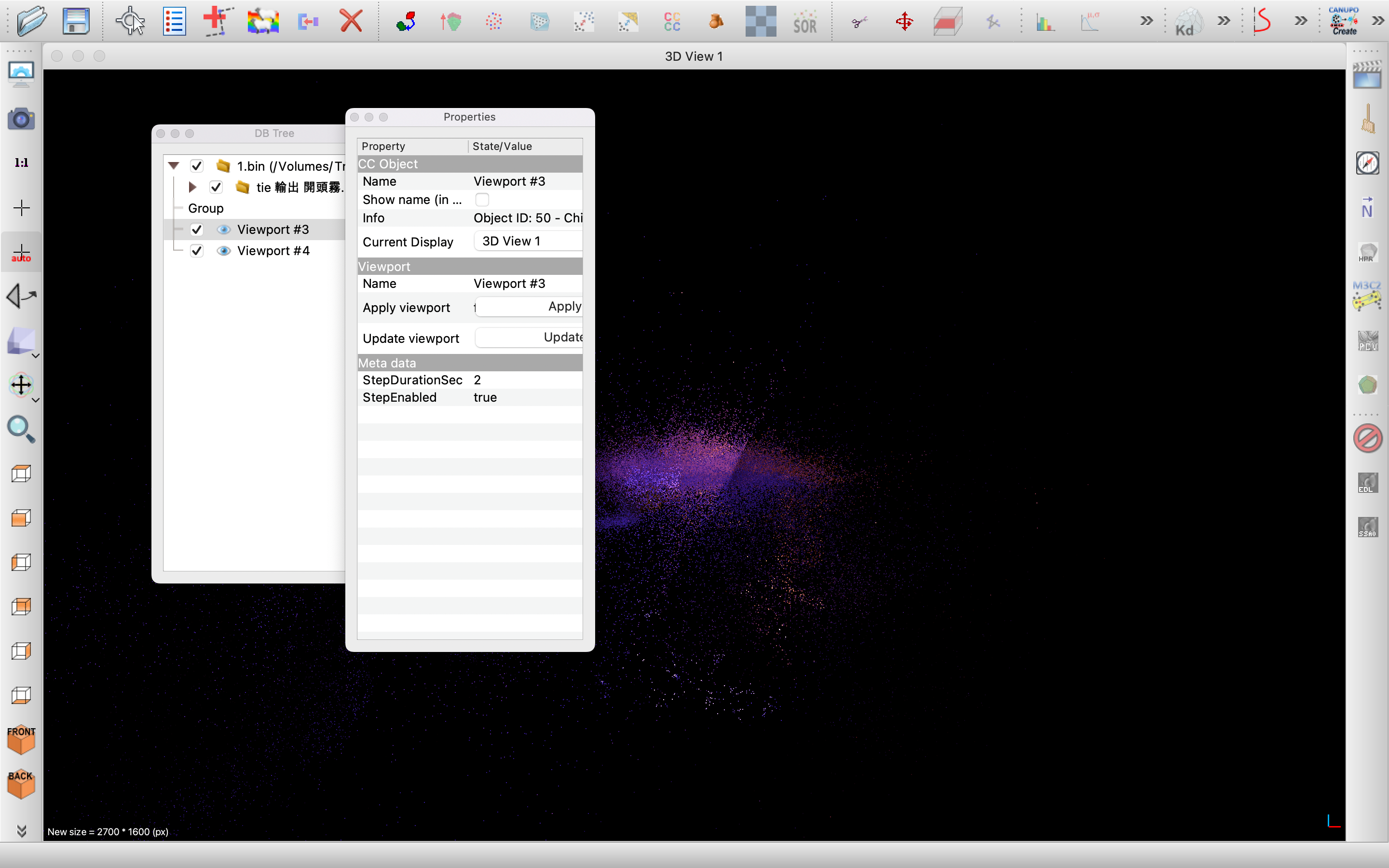

Dear Daniel,
I know that I can change the animation size through changing the 3D view size.
However, I found that 2700*1600 is the maximum size of my computer. (As the screenshot below)
Is it possible to increase the image size to 4K(3840*2160) when rendering?
Thank you so much!

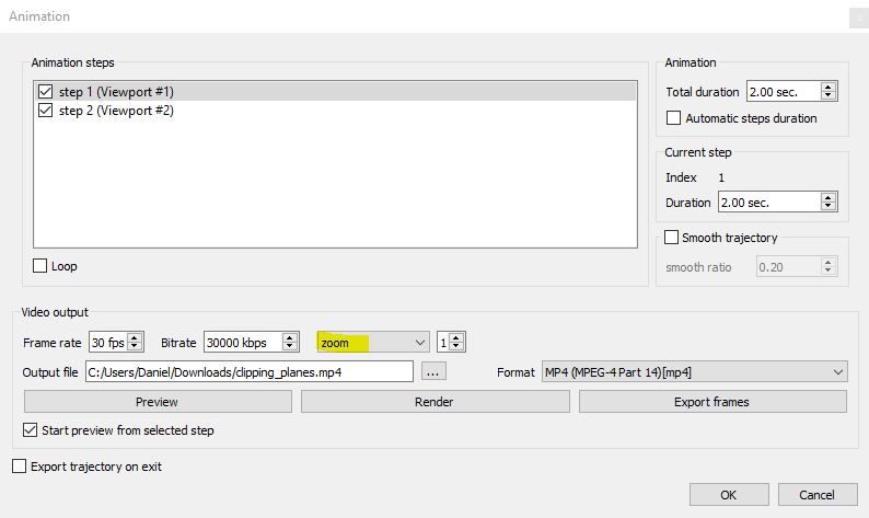

With recent version of CC, you have a 'super resolution / zoom' combo box:
