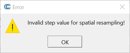

Do you guys see anything wrong with this code? I am trying to subsample, save and merge point cloud files.
I am getting this error
Re: Getting Invalid Step Size for Spatial Resampling with using Commandline CC
What does a command like 'echo %SubSamplingDensity%' would output?
Hum, then I don't know! We would need a batch script expert...
(and I guess you've tried to replace %SubSamplingDensity% by 0.1 in the script to check that the problem comes from here?)
