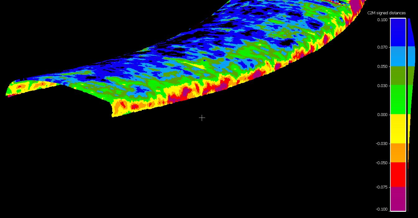

The point is, that I have a point cloud and model in dxf. I know how to compute these two files.
Now, I want to know, for some specific values ( let´s say, a value which is bigger than 8cm from the model, or according to color scale )the area or percentage for these values
In the picture, you can see red and purple values, that are interest me
Thanks a lot

Hum, sadly I don't see an obvious way to do this...

Any advice, which software is able to do, please? :)

You may export color to SF , then filter by SF value to get 2 pointsclouds
