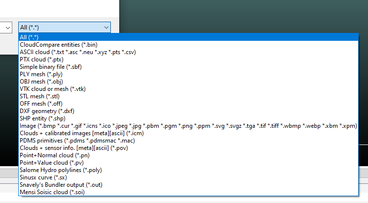

I'm using the Windows .EXE, its appears that E57 is not the only format that is missing from your list.
CC import.png (17.61 KiB) Viewed 137713 times

In the Console of CloudCompare (F8), do you seen some error messages about CC failing to load some plugins maybe?
Depending on how you compiled the plugin, it may have dependencies to DLL files. These DLL files needs to be found via the system PATH variable, or they have to be copied next to CloudCompare's executable.

daniel wrote: Mon Apr 17, 2023 7:11 pm In the Console of CloudCompare (F8), do you seen some error messages about CC failing to load some plugins maybe?
Thanks, actually there is an error message: "QE57_IO_PLUGIN.dll does not seem to be a valid plugin (Cannot load library C:\Program Files (x86)\CloudCompareProjects\CloudCompare\plugins\QE57_IO_PLUGIN.dll)"
I copied QE57_IO_PLUGIN.dll from "/plugins" next to the executable, but still the same error message pops up. Is there anythings else i can do or have to do?
Thanks a lot
Posts: 8244
Re: Can't open E57 point clouds despite plugin installed
No, the plugin DLL should stay in the 'plugins' directory.
It's the dependencies that should go next to the executable file. You can use the 'Dependency Walker' tool (https://www.dependencywalker.com/) to check what your DLL is expecting. Probably the Xerces DLL and maybe some others.

Thank you, it works now. Only the xercesc-DLL was necessary.
