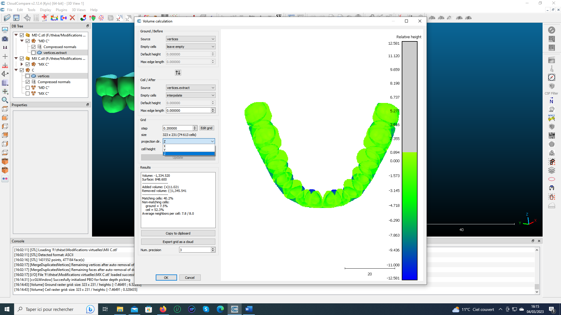

For my thesis, i would like to compare 2 models and know at what point they are different.

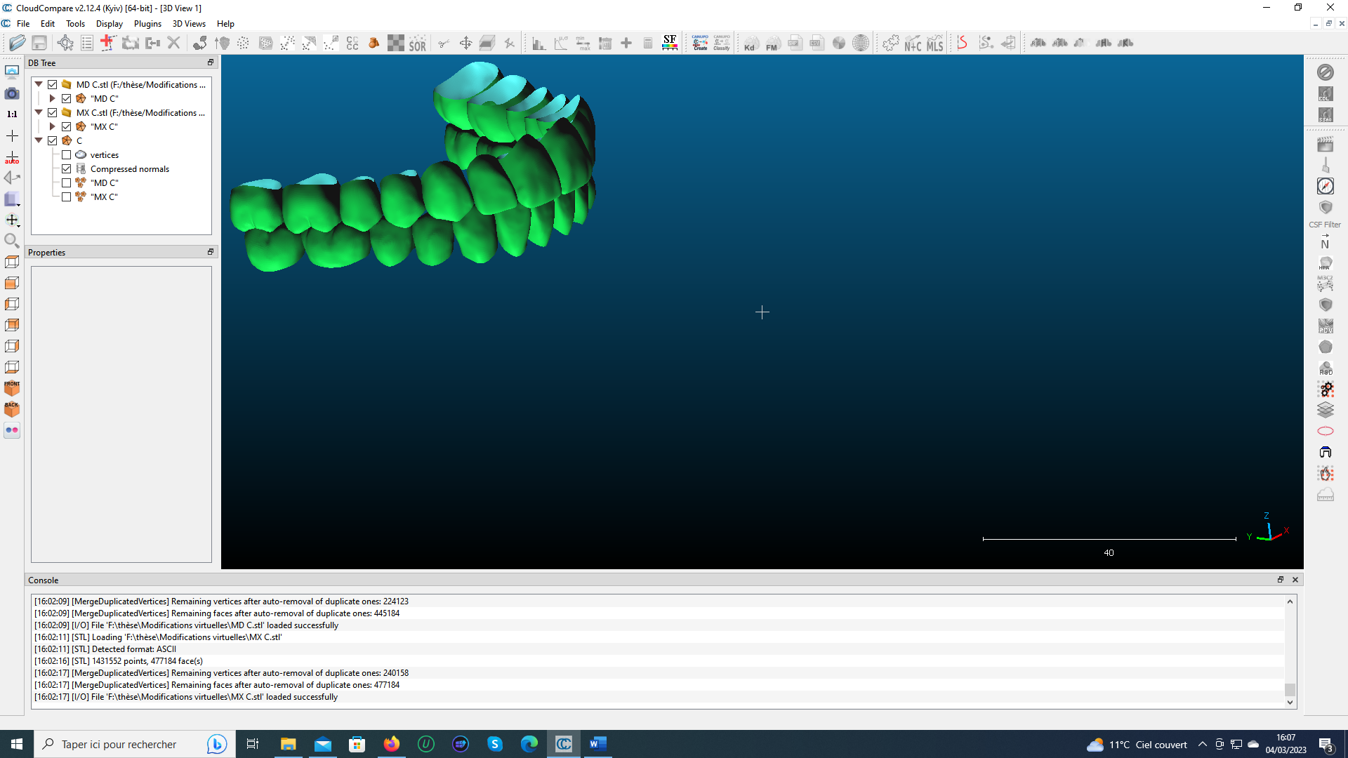

In my exemple, the "C" is made of "MX C" (the up part) and "MD C" (the down part).
FAQ CC 1.png (286.03 KiB) Viewed 2263 times
From what I've learned, I have to go to "Tools => Volume => Compute 2.5D Volume" after having them aligned. I don't know if I have to use only "interpolate", "average height", "leave empty" or a mix of those (I tried the combination of all of them even if I mostly tried 2 "interpolate" and also "leave empty".
If I add the percentage of the matching cells of MX C compared to C and MD C compared to C, i'm never close to 100%. I can be far beyond or beneath and I think it's because of the "projection direction" that can only take one plane at a time.
FAQ CC 2.png (275.58 KiB) Viewed 2263 times
Is there a way to get the percentage matching cells of the whole model, in all the planes at once ? And so having MX C + MD C close to, when compared to C, 100% ?

I'm not fully sure to follow. Why would you use the 2.5D Volume calculation tool to compare the models? And not the distance computation tools?
Otherwise you are right, you have to rotate the entities so that the 'comparison' direction corresponds to the X, Y or Z axis. And you'll only be able to compare one direction at a time with this approach.
