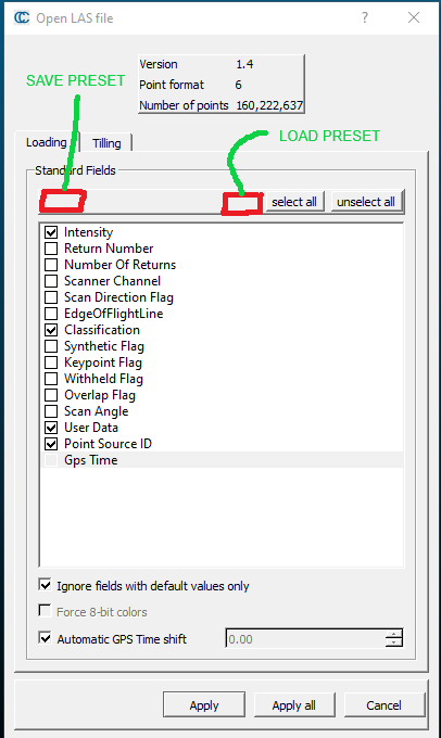

When one goes to load a LAS file in '2.13.alpha', a dialog box pops up with all the LAS "Standard Field" variables so one can specify which ones to load.
Can a modified "Standard Field" format be saved to a DEFAULT state so ALL LAS files are loaded with this 'pre-set' format until the load specifications are reset manually?
The reason that I am asking is that I am loading a large number of LAS files (probably around 40) and it would be helpful to have the 'standard fields' pre-set to a user specified configuration.
Suggestion - 1) SAVE PRESET 2) LOAD PRESET 3) Select All 4) Unselect All

Yep - I can see the "Apply" and the "Apply All" buttons at the bottom, the issue lies when all the LAS files are not in the same directory structure. Hence, the re-application of the same 'customized' Standard Fields. As well, it would be good to load in the customized format all LAS files I want to work with all the time.

Hum, that would be an interesting addition. I'll add it to the TODO list (but I really can't guarantee when or even if someone will do it!).
