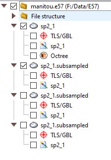

By "subsampling", are you really referring to the 'Tools > Subsample' tool? (because I tested on my side, and it works (and for all three ways of subsampling).
Or are you referring to the 'Edit > Octree > Resample' method maybe?

Yes, I am talking about the subsampling tool. What is that other child with the paintbrush next to it in your tree? Could that have something to do with it?
Posts: 8244
Re: Subsample .e57 cloud and then estimate normals with sensor
No that's an image, and they are copied as well when segmenting or subsampling a cloud (as well as other types)
