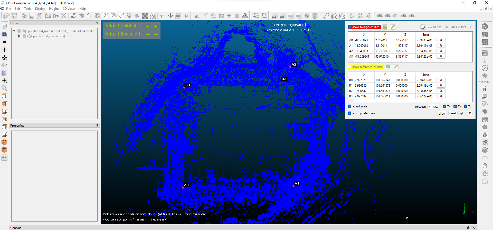

I just learned how to align one cloud with the real coordinates. When I finish pointing the coordinates, I click align and press Enter, it becomes like this.
If you notice, the scale on the right bottom becomes smaller.
It becomes a problem for me when I upload it to Tier4 Vector Map Builder. The PCD does not load anything.
Question is, how can I do georeference properly without the PCD data becoming smaller (compared to using a scale)?

I'm not sure if it's large or not. The local coordinates in PCD are as follows:
-88.459938, 2.612011, 5.125117
14.940063, 4.112011, 1.525117
11.940063, 115.112015, 0.225117
-87.259941, 95.912010, 3.825117
And global coordinates that I align the point pairs are:
2.92782083, 101.66214713
2.92698574, 101.66187756
2.92664684, 101.66282667
2.92748175, 101.66301075
For the Global Shift, when I load the PCD, it didn't ask to apply Global Shift. Do I need to convert .pcd to .las first? Or I can just directly adjust Global Shift?
Below I attached my screenshot of aligning the pair points.

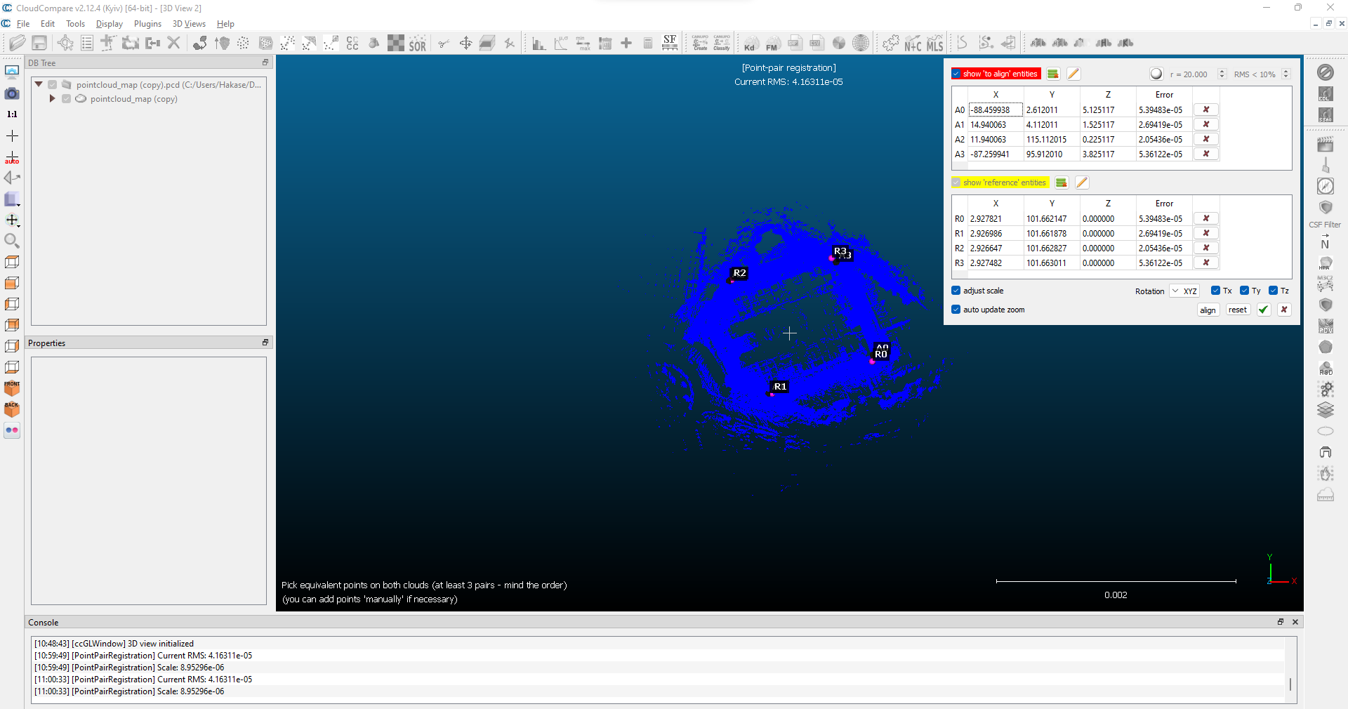

If you notice, the scale now is 85. This happened when I click align. It rotates the PCD and the scale becomes smaller. The scale is now 0.002
Re: PCD data scale become smaller
Ah, I understand now. Since all the Z coordinates of your reference points are 0 (= 2D points), and you tell CC to scale the align cloud (3D) to best fit the points, it ends up rescaling the aligned points with a ridiculously small scale (so that 'P.z * 0 = 0' basically).
You can't align 3D points with 2D points this way... You would have to make a clone of your cloud first, then flatten this clone (with 'Edit > Multiply / Scale' and use 0 for the Z coordinate only). Then align the flat clone with your 2D reference points. Look at the resulting matrix in the Console (F8) and copy it (CTRL+C). And eventually, you can apply the same matrix to the original point cloud with 'Edit > Apply Transformation' (and paste the matrix there, either with the 'clipboard' button or with the CTRL+V shortcut).

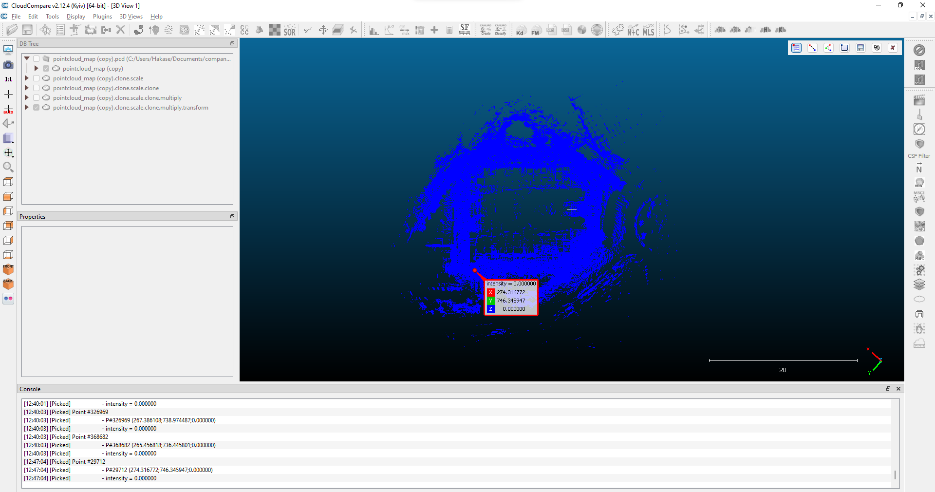

I've tried your method, but it seems the scale still become smaller. I recorded my step and posted it on Youtube, can you check and point out where I did my mistake? Here is my video link on Youtube.
https://youtu.be/5CEO4O8Vt6E
Glad you can help me with this. Thank you for your time.

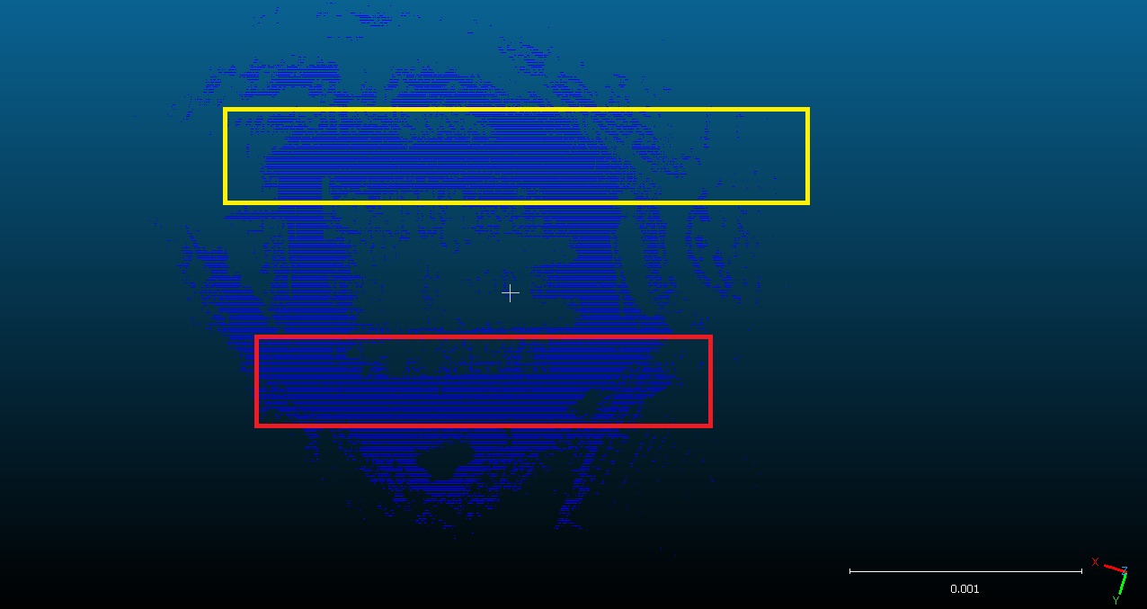

EDIT:
I just found out. The global coordinate after alignment and scale is a bit weird.
The picture above is after alignment. What I can see is the coordinates in the yellow box should be in the red box, and vice versa. But it's fine on the left and right sides. Do you know why this happened?
Below is example:
Thank you!
Oh, I think it doesn't really makes sense to use 2D angular coordinates to match 3D cartesian coordinates... The 'align' tool performs rigid registration, and I'm not sure that converting from cartesian to angular coordinates is particularly 'rigid'.
The other issue, once again, that the resolution of the 4 pairs of GPS coordinates you picked in Google Maps is actually very coarse (something bigger than 10 cm in average I believe). You would need more digits to get a reliable result (an angula resolution that would be equivalent to mm accuracy I guess).

Well, my point was only to improve the numerical accuracy and fix this 'strips' issue.
But I still think you can't register a cartesian 3D point cloud with angular coordinates with a rigid registration algorithm such as the ones implemented in CC.
