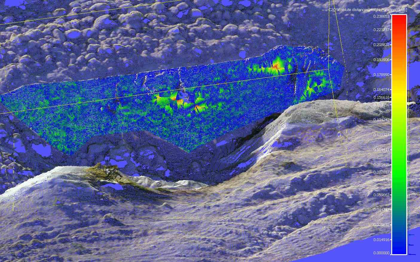

Hi all,
I want to compare a sparse pointcloud (it also contains some holes) with a dense one. I used height funkction (kNN=6) to get "best" results....mean of result is fine, but how to understand peaks of histogramm next to the legend of scalar field? If I adjust higher value for Points(kNN), results will get worser. Which value should you recommend? Is it better to use a value for radius?
Screenshot is attached
Regards,
Claudia
C2C Distance - Histogramm
- C2C_Distance_screenshot.JPG (180.25 KiB) Viewed 6380 times
Re: C2C Distance - Histogramm
In fact using a fixed number of points only works for cloud with a constant density. Moreover 6 seems very low (this is the theoretical minimum).
You should use a radius-based neighborhood. And for the choice of the local modelization to use, it's not always evident. Triangular meshes are best suited for very clean clouds with sharp edges. Height function is best for smooth/curvy shapes. But both are very sensitive to noise. The least square plane is more robust but also less accurate (it mainly works for planar shapes).
Anyway, even in the best case, there will always be some "wrong" distances locally. The local modeling scheme provides more robust results only in a global point of view.
