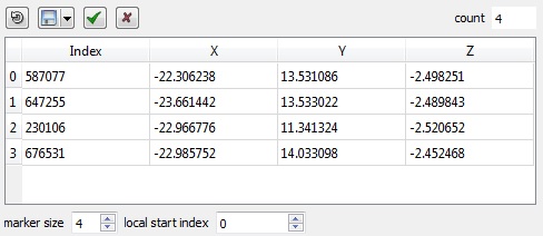

I can't reproduce the bug... Here is what I get:
Can you post a snapshot?

Have you tried with the "point list picking" tool?

Yes, the "point list picking" tool works great. I use both tools, and have different use cases for each. In this particular case, I need to display the vectors that the simple "point picking" tool draws between pairs of points, and also need to get the x, y, and z offsets independently for these points. As a workaround, I exported the points in my cloud to an ASCII file, and then just looked up each point in my vectors from that file by point number.
