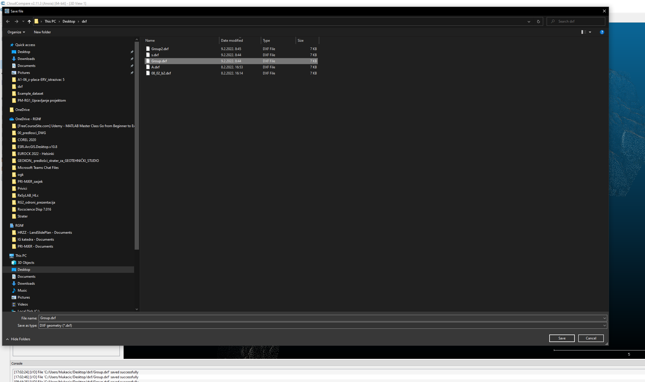

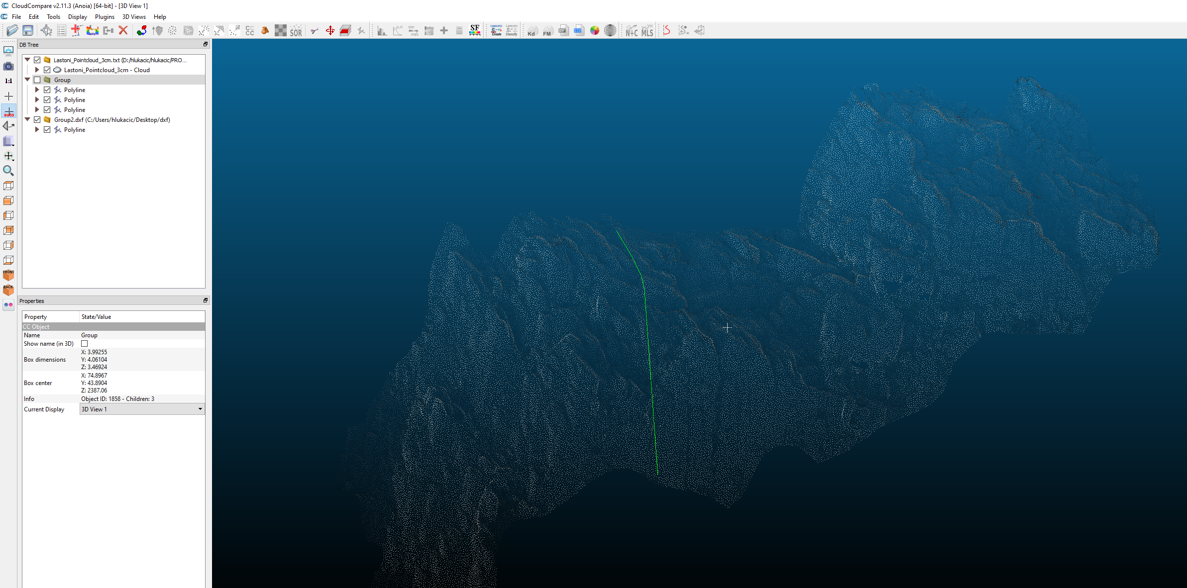

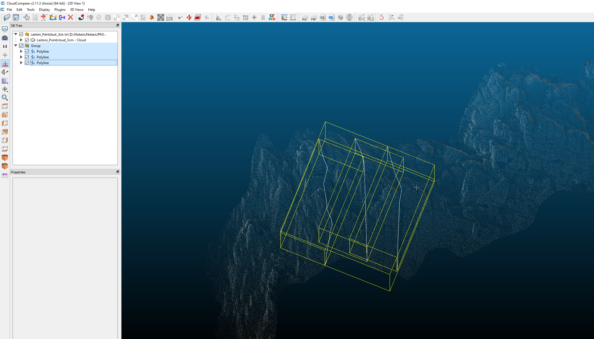

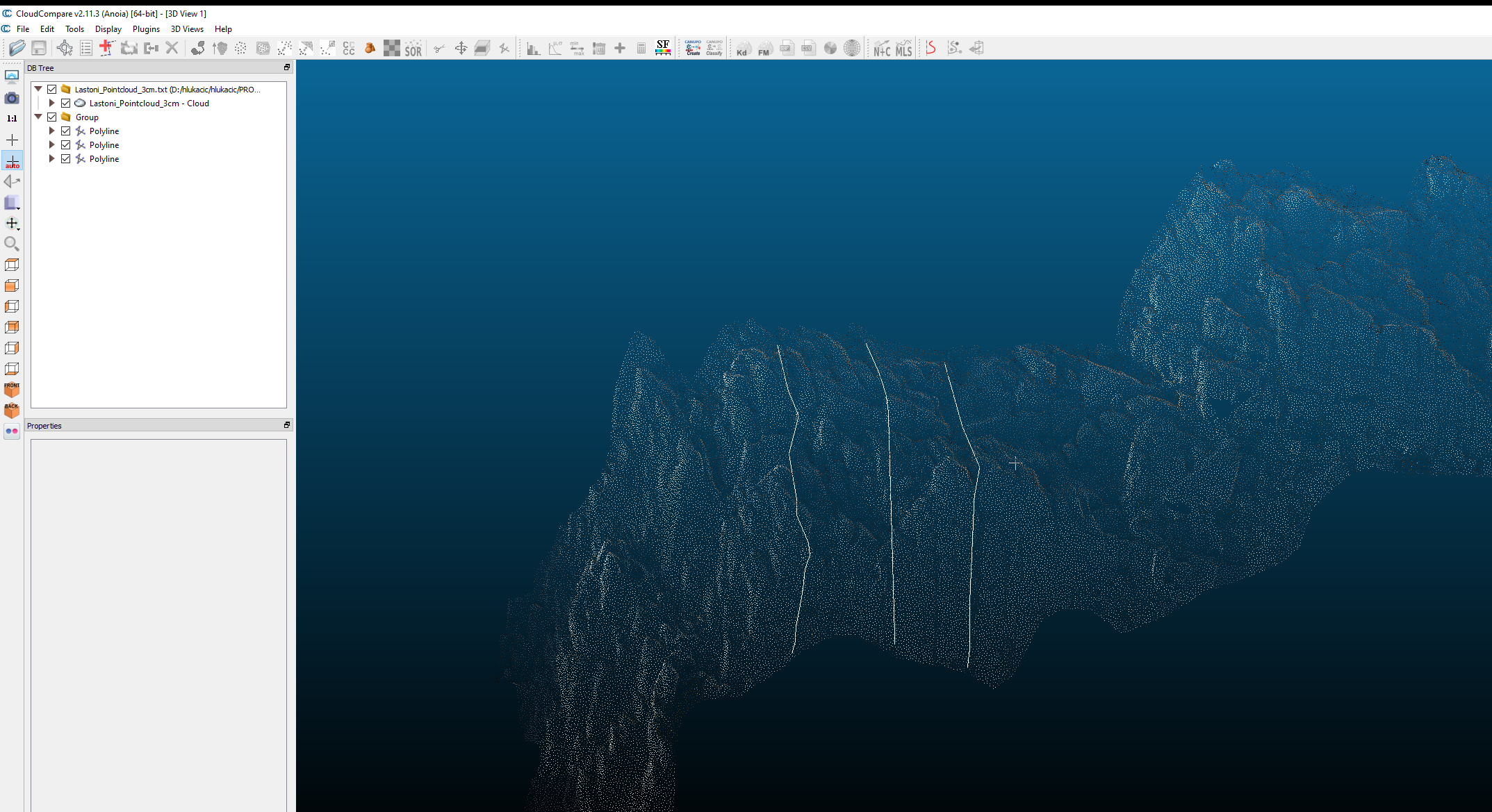

I draw three "Trace a polyline" and joined them under the same group. Then I tried exporting them in two ways: first click on the Group and Save - dxf and it only shows the last polyline in the DB Tree. Second, I did not join them under the same group but only selected them with SHIFT and Save export as dxf and the same problem occurred. I am using CloudComapre v 2.11.3 (Anoia). Every saved dxf file as the same size of 7 KB which means there is only one polyline saved inside it.
I am sending screenshots.
