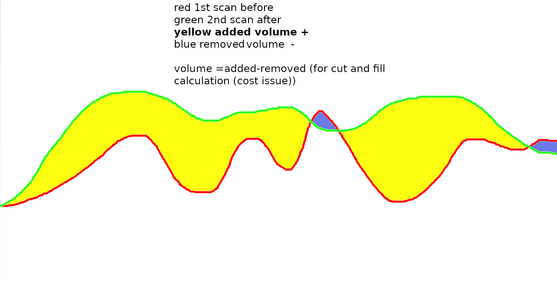

DA523
Posts: 187
Re: Compute 2.5D Volume Report Questions
Post by DA523 »
BIN FILE 2 pointsclouds
13.7z
(1.73 MiB) Downloaded 1415 times
