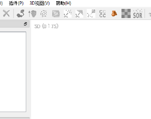

I found the rendering window is reverted. The image is in the attachments.

I found cloudcompare doesn't work in VirtualBox.
My host system is linux, and the virtual system is windows 10.
Re: Mouse cursor y direction reversed in windows 10 in virtualbox
That's very surprising (the display flip). The difference between the 'stereo' version and the 'non-stereo' version is the 3D rendering widget indeed. Normally it's managed by Qt, but apparently something bad happens. It would be hard for us to do anything sadly.
