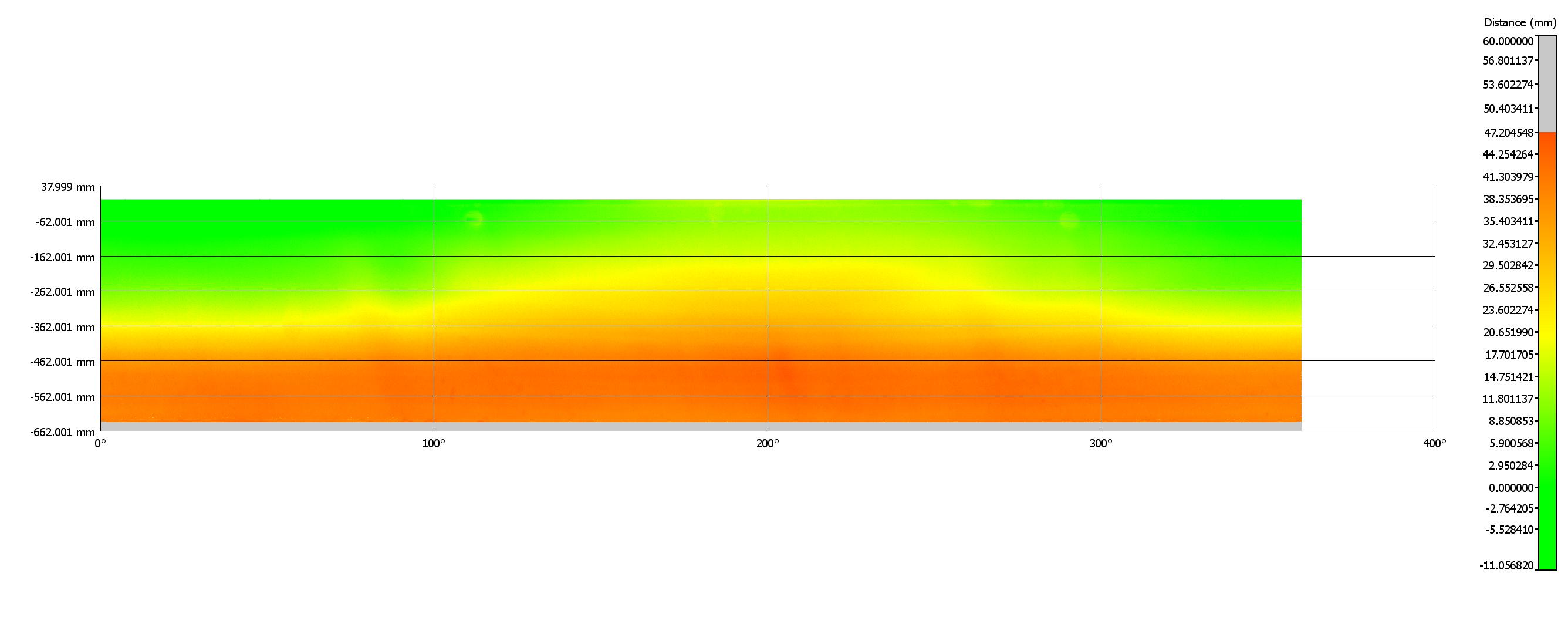

I think you misunderstood what I meant so here comes some screenshots.. ;)
My 2D-map looks like this:
As you can see the wear profile differs a bit around the part (0-360 degrees).

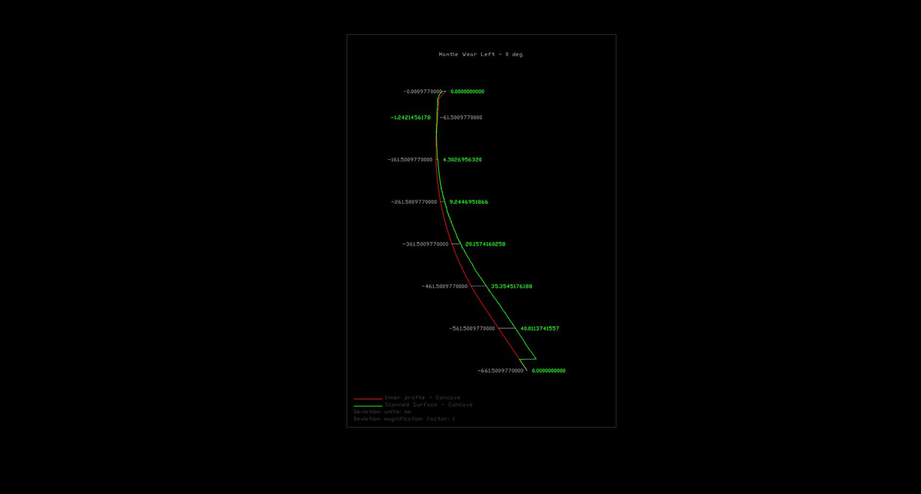

When extracting the dxf files though they look exactly the same, with the exact same values, on all different positions: (I´ve attached the 0 and 180 deg screenshots but they all look exactly the same)
So my question now is if this is an average wear profile for the whole part/rotation and if that is the case is it possible to get these profiles separate for each position around the part?

Re: Dxf export issue from the qSRA plugin
Well, in fact I hoped to find a good explanation, but this is very strange indeed ;)
You should get for each angle a different profile... I fear it's a bug again (in fact you are a kind of beta tester, as this plugin has just been released). Do you have the same issue with horizontal profiles?
I'll fix the bug and issue a new "beta" version asap.
Ok the bug is fixed. I will issue the new release this evening.
