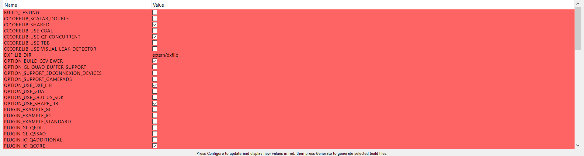

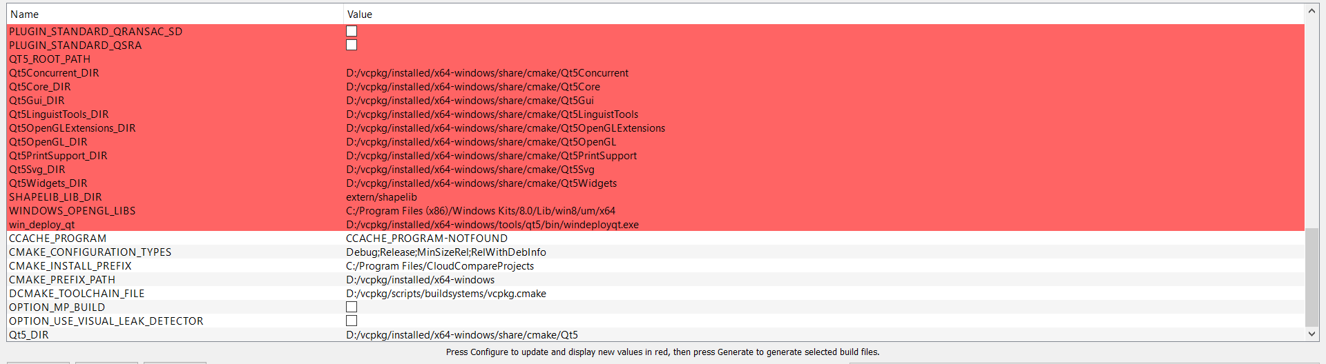

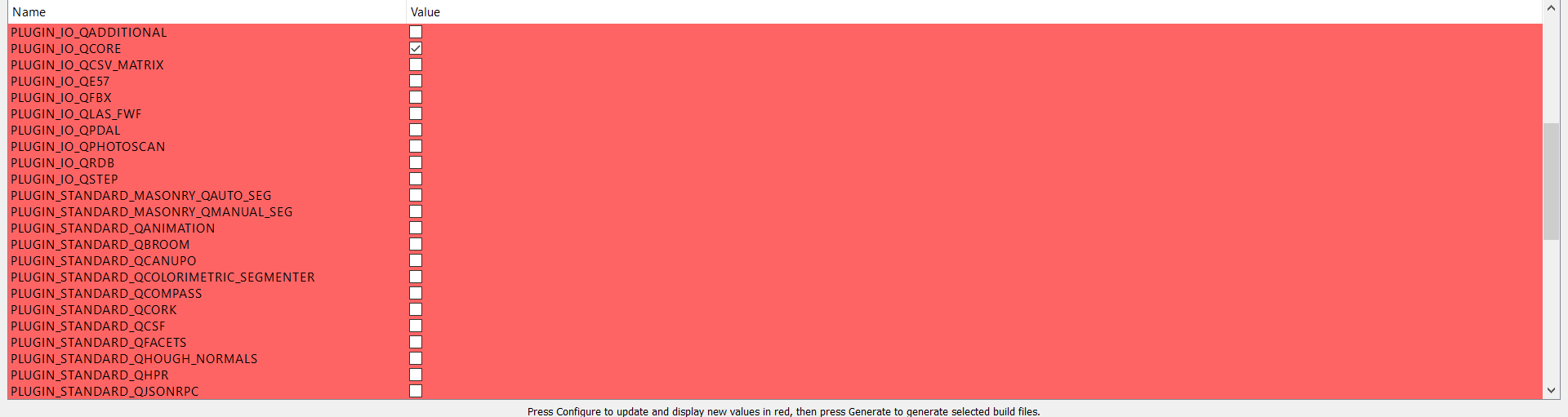

I attached you some screen of my cmake setting: what do you think could be wrong? Which flags should i disable?

Re: Compilation of CloudCompare code to change signed distance parameter in c2m_dist
I guess you can uncheck:
- CCCORELIB_SHARED
- OPTION_BUILD_CCVIEWER
- OPTION_USE_DXF_LIB
- OPTION_USE_SHAPE_LIB
But if this is what was already checked, I'm surprised you got this error...Are you properly installing all the files (by compiling the 'INSTALL' project) and then running from the 'installation' folder?
