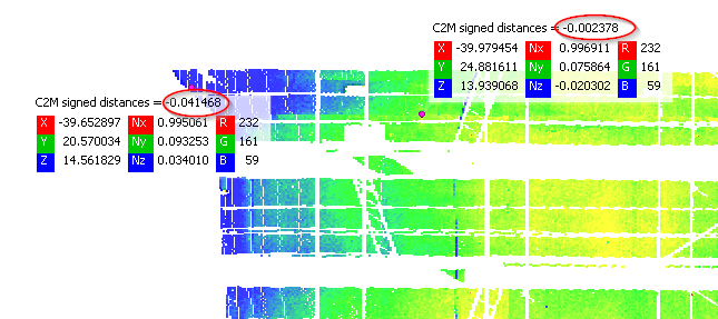

Hello! I have a similar but maybe slightly different question. How to add a label but with only one item/description. In this case, I would like a label with only the value of the distance between the models. Because I don't need other data for the description, only the distance value.
distance value.png (79.86 KiB) Viewed 16674 times
Re: How to change the label color?
Just right click on the label and it should 'collapse' (yes, that's kind of a hidden feature ;).
