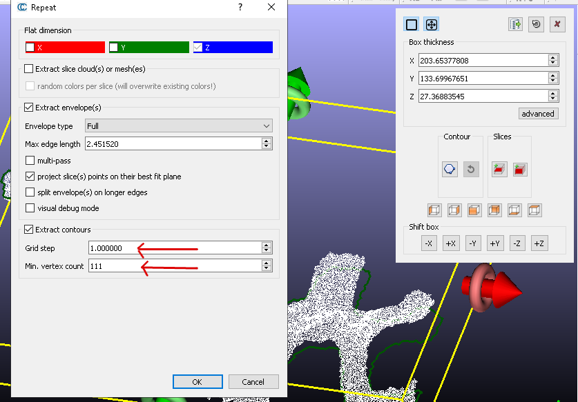

However, I found that polyline contour sometimes is not accurate in xy plane especially if there is big variation in mesh Z
see in image below
But playing with grid step & min. vertex count makes result polyline accurate in xy plane

I had good success following what I told you, zeroing out the Z value getting the contours then restoring the Z values. only extra step I didn't mention was to interpolate the original clouds SF values to the vertices of the extracted contours and restore the Z SF to the vertices as well to get the contours to follow up to the original locations.
