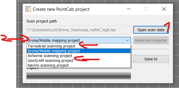

I like to add something regarding PointCab / GeoSLAM Draw:
Our LAS Import is much more robust than our E57 import, so in theory the conversion to E57 should not be necessary:
When importing a LAS/LAZ file in PointCab/Draw coming from a GeoSLAM device, please make sure that you change the project type back to terrestrial or GeoSLAM project (see image1) after choosing the point cloud.
If the issue with the decimated grid persists please contact us at [email protected], so we can fix this for all customers.
