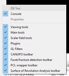

My DB Tree and Properties windows disappeared when I unplugged my second screen and I cant get them back.
The Reset GUI elements will probably work but as I cant select the top level DB Tree item I cant save my work before closing.
A RMB on the toolbars shows them greyed out and unticked.
Is there another way of saving everything?
Screenshot 2021-03-04 175944.jpg (21.77 KiB) Viewed 6138 times

Oh! Too bad...
At least you can select all the entities visible on screen (you can use the ALT + draw a rectangle on the screen with the left mouse button to select all visible entities), then use CTRL+S to save them...
