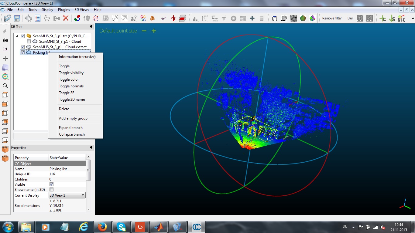

Where can I find align camera.
- CC_question.jpg (238.12 KiB) Viewed 14575 times
Re: Define user coordinate system
Here it seems you have used the 'Point list picking' tool ;)
The "Point picking" tool is the icon right next to it, on the left. Once your triangle label is created (and saved) it will appear beneath the corresponding cloud in the DB tree.
