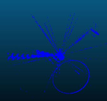

if I save a small part of it it as las and read it again, I 'm getting a single value of intensity which is not real one. please see attachment.

- result
- las_2.JPG (14.1 KiB) Viewed 14773 times

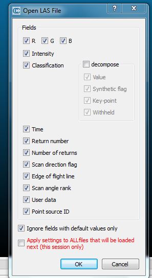

- reading file
- las_1.JPG (35.08 KiB) Viewed 14773 times

For the LAS issue, I can't reproduce the issue. Are you sure that each time you are displaying the 'Intensity' scalar field? Is there warning messages in the console that might explain this issue maybe (not enough memory, etc.)?

For the 1st point: I do use the last version myself. And I can't reproduce this issue. Can you share your file with me maybe (at least the small part)?
