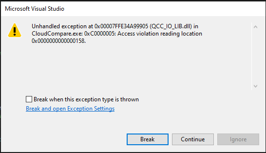

returns the following error:
Using:
save(cmd, files, selectedEntities[0], QString("Export"), QString("PTS"), saveParameters);
Works great. If I only want to save the first cloud.
But Using:
save(cmd, files, selectedEntities[1], QString("Export"), QString("PTS"), saveParameters);
I dont get an error, but no cloud is saved in the output directory.

Yes, it crashes on the following in the main method:
1.		for (int i = 0; i < selectedEntities.size(); ++i) {
2.			//convert each item into a cloud and store as a child of "CCHObject* projectGroup"
3.			//ccPointCloud* pc = static_cast<ccPointCloud*>(selectedEntities[i]);
4.			ccGenericPointCloud* pc = ccHObjectCaster::ToGenericPointCloud(selectedEntities[i]);
5.			ccHObject* tempObj = pc->clone(); //ISSUE Crashes on this execution due to trying to clone null object
6.			projectGroup->addChild(tempObj);
7.		}
8.		save(cmd, files, projectGroup, QString("Export"), QString("PTS"), saveParameters); //This calls upon saveToFile method mentioned below
The error shown while in debug is as follows:
Code Broke at: AsciiFilter.cpp, saveToFile Line 179: unsigned numberOfPoints = cloud->size();
I believe the merge function must be the issue somewhere along the lines. I am unsure where. And the function works in my other plugins.
Posts: 8244
Re: CLI Help - Adding Child to ccHObject* - CommandLine Visual Studio Debugging
Oh, indeed the ccHObjectCaster::ToGenericPointCloud method returns nullptr if the entity is not a (generic) point cloud.
Which means one of the selected entity is not a point cloud (it may be a group, a sensor, etc. - I don't know). You could display the type of the entities, or add a break point and look at it with the debugger).
Anyway, you just need to test 'pc' against nullptr, and skip it if it's nullptr...
