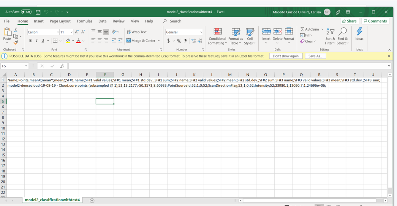

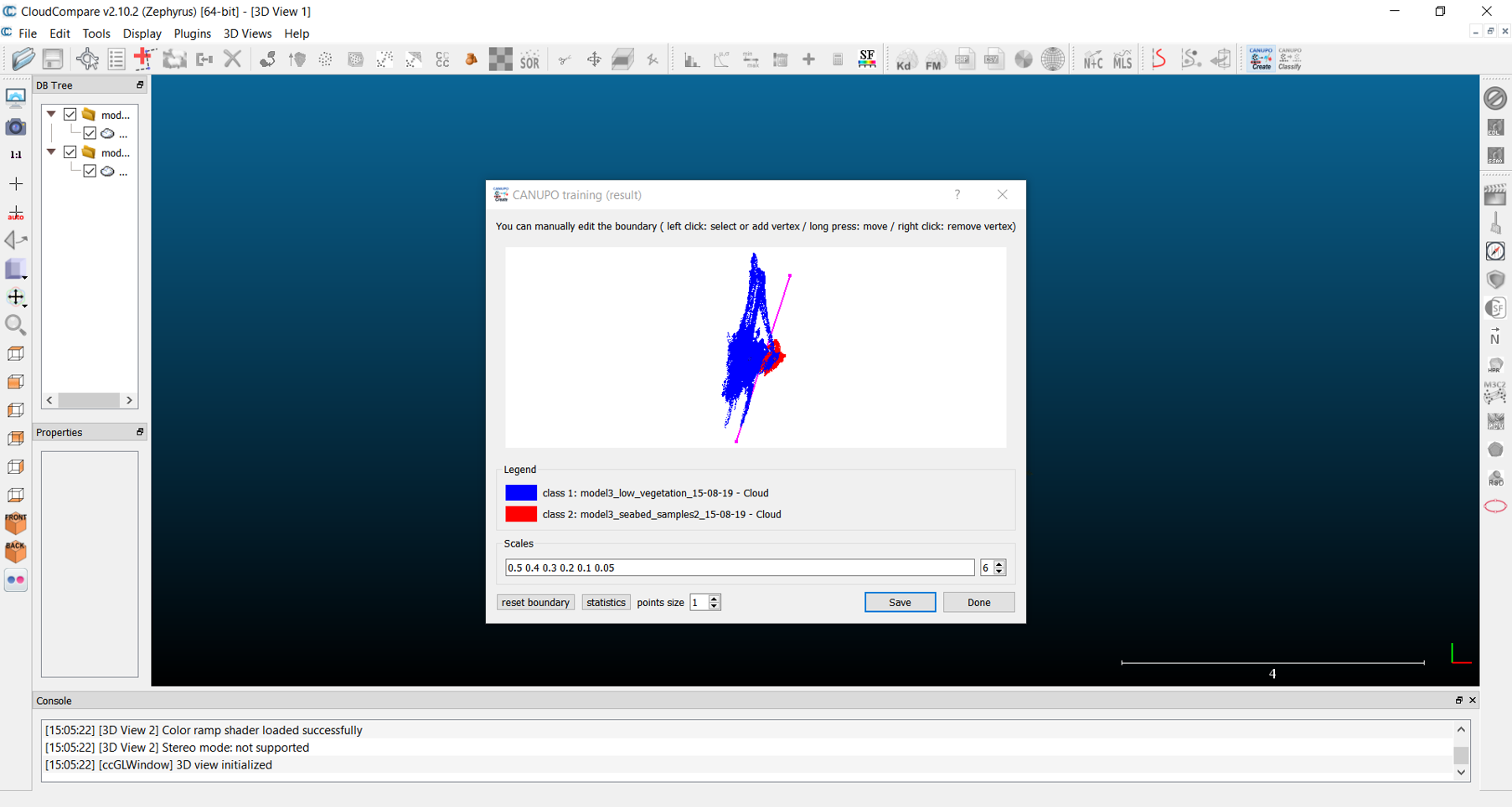

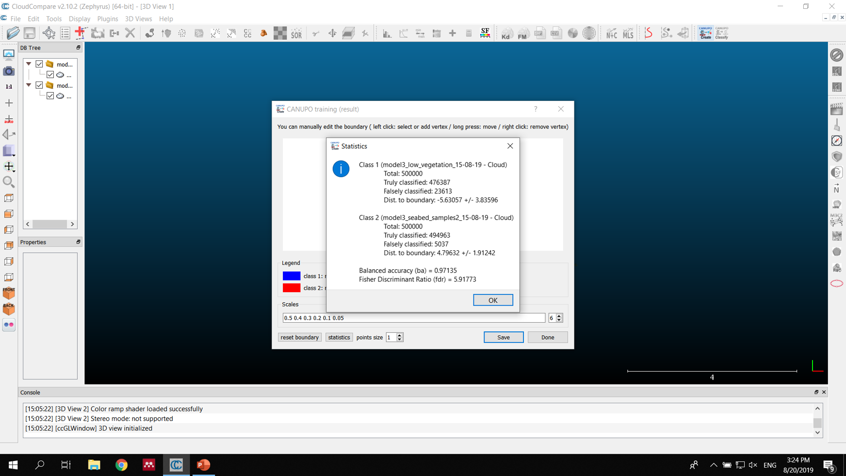

I have seen really good results with Canupo and I decided to use it as one of my testing methods on my dataset. As it is a binary classifier, I have segmented the same point cloud into the seabed (plain seabed, low vegetation coverage) and coral samples (corals branches), as the dataset is small, not many samples were used in the segmentation process. So I have created and tested 7 training classifiers so far (changing the max core points value and the scales and running them). My first question is if is there a way to export the training classifier results in the same way we see in the pop-up? Also, after I classify my point cloud, how can I export the results of it? I want to export the point cloud with the same classes results (red and blue- see image attached) and also the values for it. I have tried to export the point cloud csv but the files look corrupted( see image attached). So I wonder if is there a way to do it?
Another question is if can I create more classes for it? How would it work?
Also, can you shed some light on the classification process? i think that there is something I am missing there and there is a way to improve the whole process. Any suggestions would be greatly welcomed

Have you already read the wiki and the article? (https://www.cloudcompare.org/doc/wiki/i ... O_(plugin)).
The trick is of course to find the right scales... and use good training samples.

- when you see 'export the results', what are you thinking about exactly?
- to export the classified cloud, you can simply export it to an ASCII/text file. You'll get each point along with its scalar fields - among which the 'class' one. You may have to change the delimiter to the comma also.
- if you want to create more classes, you actually have to create other classifiers that will split an existing class in two (for instance if you have 'seabed / non-seabed', then you can classify further the 'non-seabed' class into two new classes). In effect you have to apply the first classifier. Then extract the points of the second class (with 'Edit > Scalar fields > Filter by value'), and then apply the second classifier to these points. The original CANUPO tool had the option to create a 'tree of classifiers' that would do this automatically, but this is not supported by the GUI version integrated in CloudCompare.
