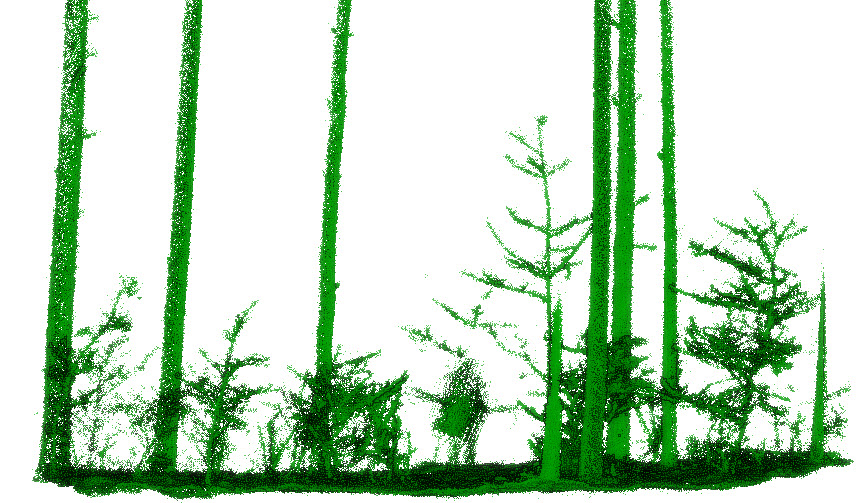

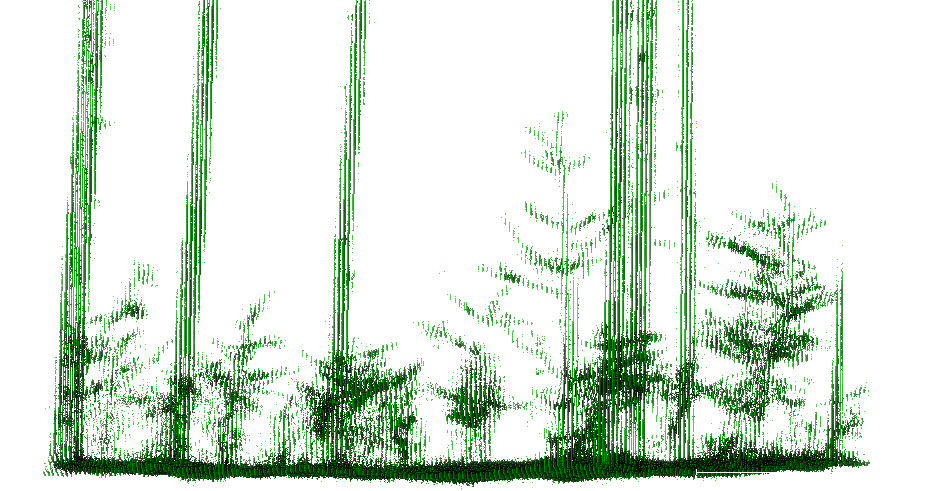

When applying a transformation matrix to any point cloud (apparently regardless the number of points) using CloudCompare v2.11 Alpha, the quality of the data decreases -the point clouds lose accuracy as in the screenshots attached (they are the same point cloud. Left: original; Right: transformed).
Issue after applying transformation matrix2.png (641.82 KiB) Viewed 19404 times
This does not happen when transforming the point cloud with the Translate/Rotate tool.
Thank you so much.

What kind of transformation matrix do you input? Can you give us an example?
And does the cloud have large coordinates maybe?

I have the same problem, I'm losing the precision of the point cloud after the application of the transformation matrix. You can see below how my point cloud looks like before and after transformation.
before:
after transformation:
I want to transform my data from a local coordinate system to a national coordinate system. I further steps I'll want to process data and get the georeferenced output which will be ready to use in the field with GPS app.
Is there a way to do it without losing the precision ?

And when you input such a transformation matrix, CC doesn't ask you to apply a Global Shift? (if yes, then you should accept this temporary shift).
Which version of CloudCompare are you using?
