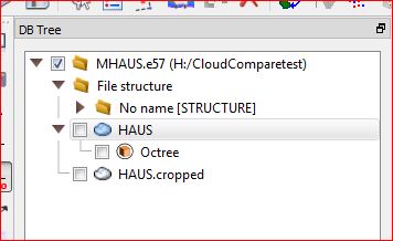

I am trying this
"C:\Program Files\CloudCompare\CloudCompare" -AUTO_SAVE OFF -o "H:\CloudComparetest\MHAUS.e57" ^
-CROP -3.3087:-2.6080:-1.3729:-3.2041:-0.8512:0.7371 -C_EXPORT_FMT E57 -SAVE_CLOUDS FILE "Croped_1" ^
-o "HAUS.e57" ^  // DONOT KNOW HOW TO SELECT IT FOR FURTHER SEGMENTATION
-CROP -2.001217842102:0.158620119095:-1.146977663040:1.790810465813:1.038823127747:0.860960900784 ^
-C_EXPORT_FMT E57 -SAVE_CLOUDS FILE "CROPED_2"
HAUS IS CLOUD NAME WHICH REMAINS AFTER SEGMENTING CROPED_1, I WANT TO ACTIVE THIS AND FURTHER SEGMENTATION TO AVOID LOADING CLOUD AGAIN AND AGAIN: IS THERE ANY OPTION.
