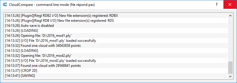

All I'm trying to do the same with -VOLUME causes a CC crash. Some examples:
...-VOLUME -GRID_STEP 0.085 FILE D:\result1 D:\result2
...-VOLUME -GRID_STEP 0.085 FILE "D:\result1 D:\result2"
...-VOLUME -GRID_STEP 0.085 -SAVE CLOUDS FILE D:\result1 D:\result2
...-VOLUME -GRID_STEP 0.085 -SAVE CLOUDS FILE "D:\result1 D:\result2"
Always CC says "Ne répond pas" as you can see on the image.

Okay that's fixed (it was indeed a bug, the tool was not expecting any other command after its own options). The new version is available online.
And by the way, the correct syntax to save multiple files is:
-SAVE_CLOUDS FILE "input1 input2 result"
(mind the quotes, and the fact that there are 3 clouds after the tool runs: the 2 input clouds that remain and the resulting difference grid as a 3rd cloud)
