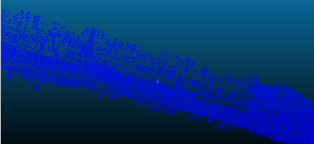

For those who have used the Canupo command line suite- have you ever encountered classification results that are missing huge stripes of data? (see photo below)
When I used the plug-in version in CloudCompare, I never had results like this. I've tried creating and using several variations of the .msc file to see what effect is has but with no success. I'm scratching my head here- any ideas?
Thank you!
Thank you!
