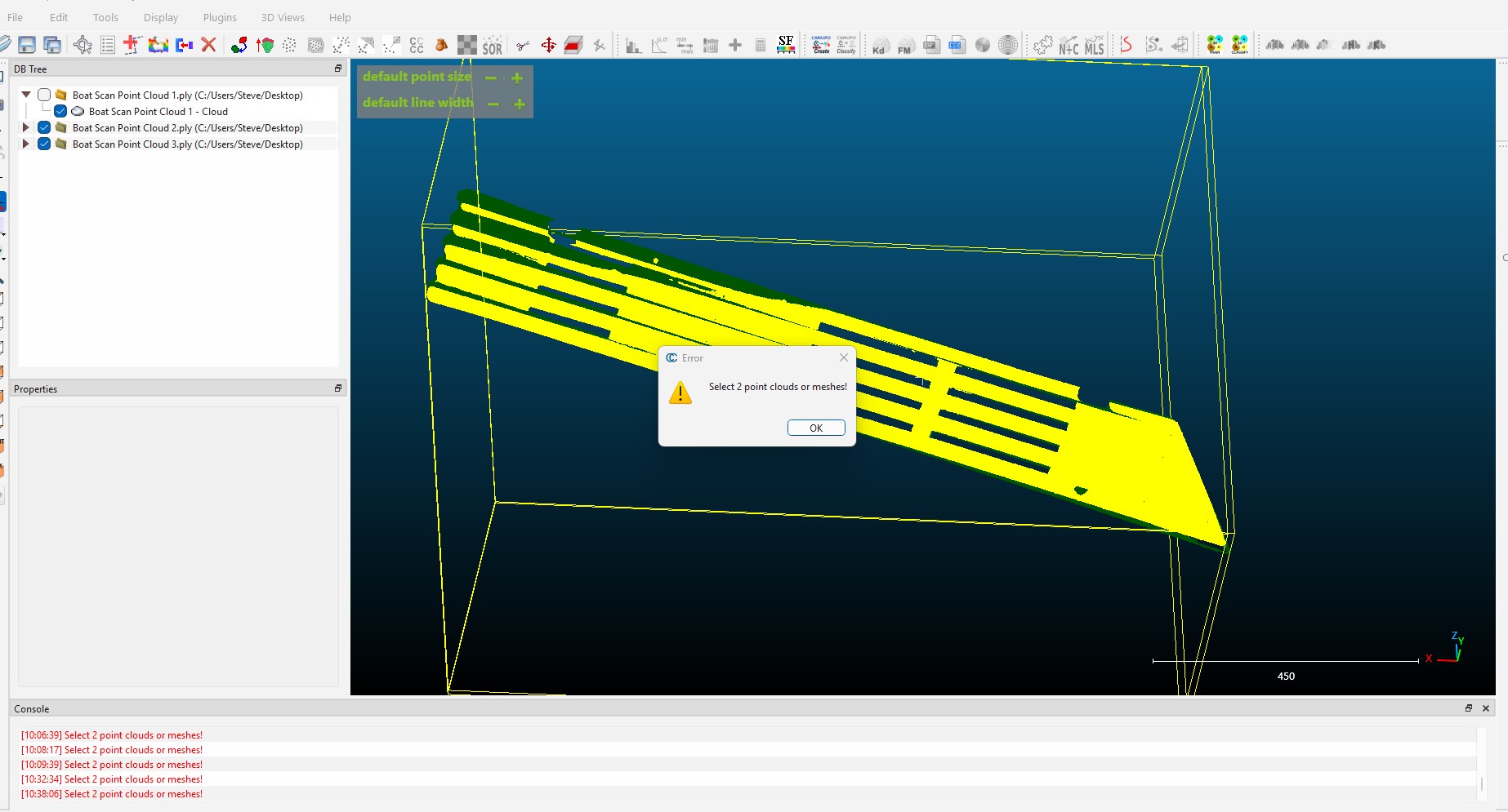

Hello Everyone,
I am trying to merge several point clouds to create a single model. I have roughly aligned two point clouds, and when I select the finely register two point clouds or meshes, I receive the error: "Select 2 point clouds or meshes!". Can someone please explain what I am doing wrong? Thanks in advance for everyone's help!
Cloud Compare Error.jpg (232.2 KiB) Viewed 26149 times
Re: Finely Register Error
Yes, you have to select the entities (inside the 'folder' or 'group' entities that we can see on the capture). Each time you open a file, a 'group' entity is created, with all the 3D entities inside.
