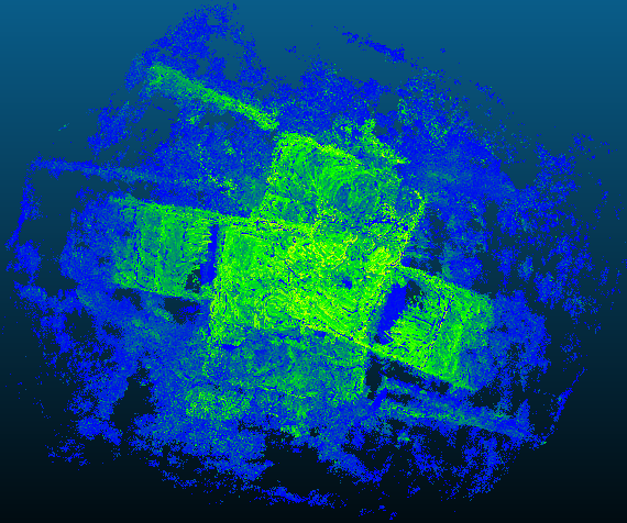

I am trying to write a python script that is able to automatically align two point clouds of nearly identical shape. I've been using the -ICP command which has worked well, but it has some limitations that I don't know how to work around. When the two clouds are on the same plane but rotated by say 180 degrees, ICP naturally does not work.
I realize that you first can manually align them, but my goal is to use the command line to align them automatically since for my purposes manually aligning many clouds is very time consuming. Do you have any idea on how I could achieve this? I left an attachment of the point clouds if it helps give a better idea of what I'm asking.
An idea I thought of is measuring what percentage of the clouds are on top of each other, and then rotating and translating it repeatedly until they are overlapping a large amount and then using ICP to finish the job. Even if this were a good idea I am not yet familiar enough with CloudCompare commands to know how the percentage could be calculated or how to automatically rotate them a certain amount.

- Two point clouds of the same shape, rotated 180 degrees
- Screenshot 2026-04-18 at 4.23.34 PM.png (290.63 KiB) Viewed 6134 times

Hum, I guess you'll have to indeed try to add a first pass to find the rough alignment. Something like what you suggest would work but it can be very time consuming (i.e. rotating the cloud every 5 degrees and trying to perform the alignment, and then keeping the best result). Or you can dabble with some feature detector, such ad the Radon transform. Or with some unique feature extraction (SIFT, etc.).
But you won't be able to use the command line only (well, apart maybe for the first brute-force technique, as you can use the 'Apply Transformation' option/tool to do it). So Python might be a good way to do it (not sure as I'm not a Python developer myself).
